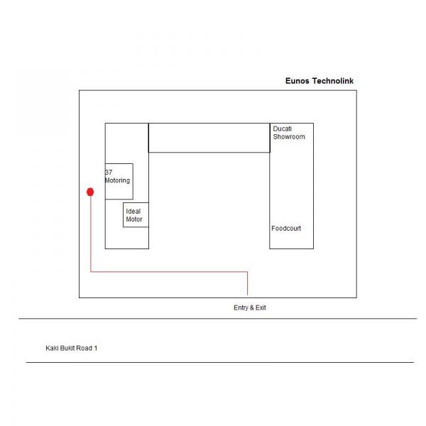

I got a tiny bit lost when I got to Eunos Technolink so though I'd put up a crudely drawn map for future 37 Motoring patrons that might get similarly lost.
