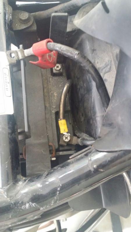

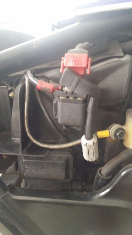

How about you try to re-rout your electrical components?
1. ERP reader rout to key switch - super easy to diy. Just connect the fuse-end (hotwire) of the ERP reader to the signal light relay hotwire (brown color). The signal light relay is underneath the front right chrome cover.
2. Do grounding to frame. Get a wire connect from the positive end of the battery (underneath the seat) and connect the other end to the nut securing the rear brake reservoir.
Or you can get a voltmeter to test the bundle of relays under the left front chrome cover. Sometimes when one of the relays are faulty, elects become crazy and weird things happen. The last time one of my relays worn out, my left signal bulb keep fusing. I literally change bulbs every few days.
