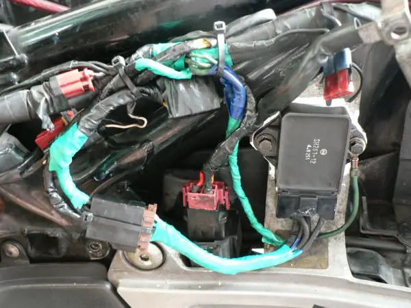

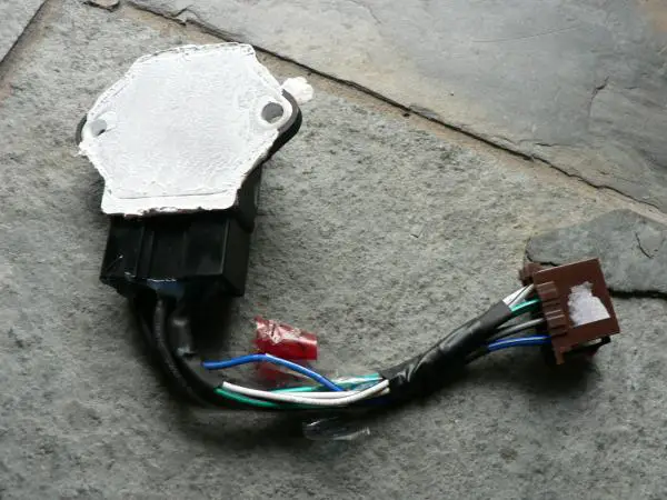

kn2i,
its common plm for pre 96' models, most u could do is bring along a spare rectifier whenever if u r leaving for ride outside Sgp.
Thanks, Simon. I've bought a new rectifier for spare (~$85) and replaced the burned connector.
:bouncefire:
who got tow bike lobang?..jus called up bikebulance and they charge $50-60 to tow ST11 lor...faintz
how much they charge u for the spare connector..?
if u r leaving Sgp for a longer ride, would be better assurance if u bring along some spare fresh wires & some copper clips, u might not know when u will need it again for the similiar event.
maintain ur battery well.

Thanks for the advise. I took some connector from vehicle & DIY still keep the old connector(warped). Actually i directly solder the wires out from the old rectifier as i have no time to look for copper clips as overcharged will spoilt the battery. Do you buy the clips from Sim Lim? However, i still can feel that it's still quite "hot" on my left footpeg holder as compare to the right...i wonder why?
