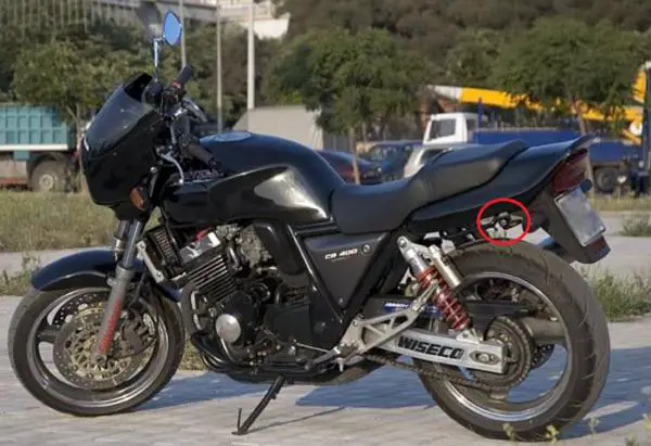

are there any ways to secure the front brakes to prevent theft? anyway to lock helmet to the bike for ver s? i tried to use the hook under the seat but than the seat cant close after that =(
My S has a helmet lock like this picture. Doesn't yours?
Go to Bukit Batok AutoBac (next to SHELL Kiosk)..they have a helmet lock kit set that u can install anywhere...cheap.

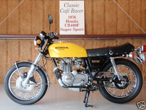

I'm pretty sure that is for a bike like this.[ATTACH=CONFIG]195115[/ATTACH]
I did find a parts catalog on this forum for the '95 NC31 and VTEC models, but no manuals. :cry:
Hmmm...my apology...that's for CB400F Super Sports not Super Four.

[ATTACH=CONFIG]195093[/ATTACH]
i dont see that on mine =(
thks mr ah pek! =D
