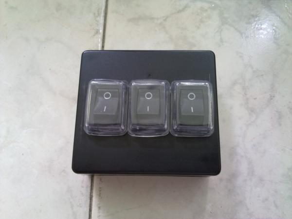

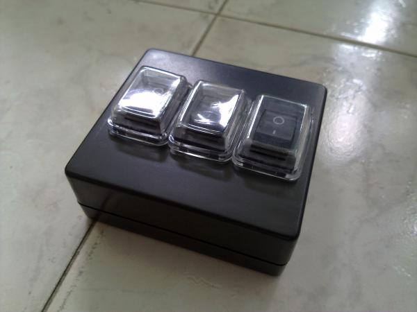

no tall hats la... i only know a little bit here a little bit there... if u wan, i can give a little bit of guidance here and there but not do everything for you... nothing is more satisfying than doing up ur own mods on ur bike... :)
a small box with a few switches for your stuffs are cool... yes u can do it this way but you got to have good waterproofing abilities on the electrics as well as water drainage function too cus u wish to mount it on ur handle bar... or u can do it smtg like the below... then route them to whatever places you wish...
erp unit is easy... headlights you just need to divert a switch into the side core plug in the left side of ur head fairing... fuse for 12v socket got to depends on what applicant you use... fog lights also depends, most of the comes with the fuse but if it does and u're unsure, you can alws refer to the manual or ask the seller...

Wahh very nice how did u cut the fairings to place the swtich really need to meet u up already very lost when I do my bike :)
take the measurements, drill small holes around the designated measurements, cut & trim a bit, then file & file & file till you exhausted and get the correct measurements to fit your switch... :)
the switch box i got it installed not on the handlebar, but somewhere else hidden... if u intending to get it on your handlebar, you got to add in some waterproofing components... :)
actually, there are many many ways you can add in switches for your devices... try going for more meet-up sessions to look at other frns how they do their switches... cus some times, it is more difficult to explain & show you the dos & don'ts in forum jus by being a keyboard warrior... :)
