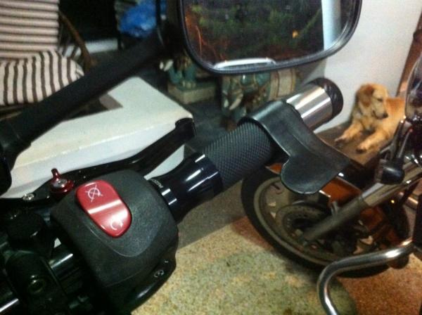

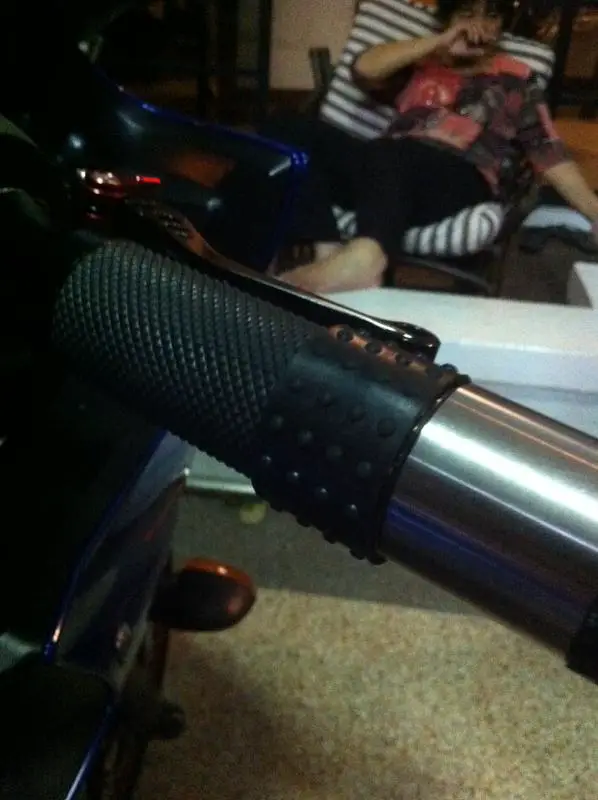

i just bought the throttle rocker from ah boy. works fine imo but could be abit dangerous lol. but there is this rubber piece like a rubber band u have to put on the throttle first before putting the rocker on. will that melt onto the grips?
hm, u got picture? mine no rubber band lei.
thats the picture of the rubber band thing and the throttle rocker goes over. i've put some old bike seat material inbetween the rubber band and the grip in case it melts.
you bought this from ah boy for $4? wah he upgrade already ah? mine also no rubber like this.
haha ya from lab. upgrade meh! no rubber like better leh hahahah
the rubber is there to have more friction mah. but it would be better if the rubber is stuck to the throttle rest/rocker.
