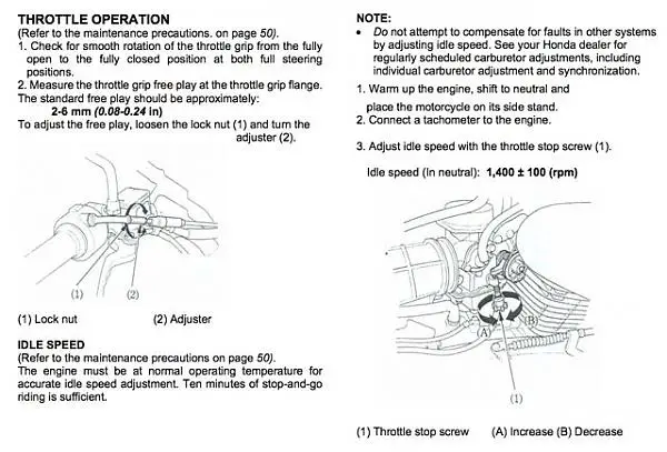

i juz changed my chain cam tensioner(to get rid of the "tak tak" sound) and batt last wk, and i noticed that sometimes my engine idling sounds very weak and it'll juz stall on its own..
even when i'm riding and i stop @ the lights or if i do hard braking, it'll juz stall on me.. can anyone help me wif tis ?
Thanks !
Increase your idling speed. Small black knob on the right side of the bike at the carburator
Bad idea until u know what is wrong
If your bike was ok before you had the work done the stalling is likely not your idle speed.... unless it was adjusted by the mechanic without your knowledge.
You changed your battery check your battery connections are clean and they are tight (weak spark will cause engine to stall when you shut off and brake)...and also when you change the cam chain tensioner it can adjust your engine timing a couple of degrees.
.... Based on his report, that is the easiest and most harmless way to check and rectify the problem. You want him to go all the way to the mechanic just for him to turn the idle knob higher? come on man... Haven even check if the idling speed is too low you ask him to check battery connection, weak spark, engine timing... Step by step lah, jump the gun so fast for what. Unless you know exactly whats wrong. :angry:

thanks for all your replies, i guess i'll juz go bak to ah cheong to check out the problem.. i wont wanna risk fiddling wif my bike, later more things go wrong:giddy: haha
relac... heh heh... adjusting the idling is ok one...
runner, b4 you adjust, check and rem it's position, then turn it slowly and see the bike response, and take note of how much you've turned it.
incase you need to adjust it back to orignal position, you can still tune it back.
ya runner , its very important to take note adjust the idling dont too much and also must remember how much you turn it... during rainy days i turn it anti-clockwise by 1/2 turn only ..after rain must turn it back again to preserve FC. Took me quite a while to turn the idling to zhun zhun steady thump...my TA200 FC now is 43km/L :cheeky:
