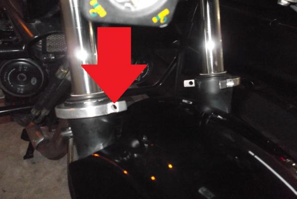

Tried to fix the fork brace but didn't succeed.
It seems that the alignment of the bolt holes on one screw is no taking into account the space used by the fork.
I managed to bolt in 3 screws, but then the last one wasn't aligned and couldn't fit.
I did not try to force too much, or move around the pieces to find a fit: I was afraid it would scratch the fork paint.
I did this in a sort of a dark place so I will try again tomorrow, this time, using some sticker tape to cover the fork to avoid scratches.
The brace with the Allen key to separate all 3 pieces:
http://i.minus.com/jisw8afVI3wG0.JPG
Pieces separated:
http://i.minus.com/j9Bz0pX31IJqr.JPG
http://i.minus.com/jbxoeGa2zbC0b0.JPG
Fixed the rings first, sliding them from the bottom slimer circumference, up to the top of the fork :
http://i.minus.com/jbkJ4bR0VfasqP.JPG
http://i.minus.com/jfKOtmJKy8je.JPG
http://i.minus.com/jbvXfhPPniPMfi.JPG
Positioned the main piece of the brace in the center and started screwing in each blot slowly, all at the same time,
each one a bit, to allow a continuous tightening of the brace at all sides at the same time.
No matter in what order I screwed the bolts in, I was always left with the front left one not fitting in the hole of the main piece:
http://i.minus.com/jbdP0upaLgNzEK.JPG
http://i.minus.com/jboxINPg6NwYCG.JPG
Of course I did this aligning all pieces as best as I could, even if it doesn't show in the photos because pieces slide a bit if you don't hold them in place - I tried to position the rigns on each fork at equal distance from the top.
http://i.minus.com/jlwuuNqNEaThV.JPG
http://i.minus.com/j2601lCkhHCFG.JPG
The photo is blur but you can see the screw getting out of the ring but not into the main brace piece:
http://i.minus.com/jbmN1Zbh6liCOC.JPG
Will try again tomorrow in day light, with the ability to play around with the rings position on the fork.
Also, it might be that because the brace is not meant to bent, and specifically meant to fit exactly, we might need to use a bit of strenght to force into position and align the last screw holes.
I didn't want to try that yet until I hear your feedback. (and I doubt I'll have the strength but we'll see ..)

Anyway, I got NGAT to fix it just now.. the process to modify it to b able to fix on our bike is quite tedious.
first of all, he need to get the hole angle correct.. he advise that when u got the brace, dun switch the side as all the holes positioning is different. My have problem as the hole is not align, so he has to enlarge. below is the pic of the hole need to be enlarge. (sorry o'ren.. have to borrow your picture)
Next.. the reason why after i tighten my brace and my fork got stuck is because the center piece is slightly loose. after tighten, the brace actually pull the fork inward and result in the unsmooth travelling for the fork. NGAT just double side tape to fill up the gap..
End result
Tada!!! the fork is performing normal and slightly more stiff than usual... having less wobble at corner also.
OH YA!!! NGAT say, make sure he is free before asking him to install fork brace as this process need take some time for trial and error.. hahaha!!!

Oh boy.. but I thought they tested it before sending to us .. :slapforehead:
@mjbs64, it's feedback time to them hehe.. Cannot be must drill the hole to enlarge, then some more tape and whatnot... :nono: :nono: :nono::nono:
@Charlton: how much did you pay for it to be installed ? And can post the pic with what to drill I think you used white color, hard to see..
Thanks a lot for the feedback ! :thumb: :thumb:
Yeah, immediately saw that by DIY very likely to scratch the fork paint so I just thought I'll do this when I can put some sticker to cover and protect..hmm.. *scratch head*
@O'Ren check out the pic.. the red arrow pointing is the place that NGAT drill as the alignment of the screw is slightly off after inserting tape to the center piece.
sorry.. have to use your pic as i am now lazy to walk to carpark.. hehehe..

@Charlton, ok I see, thanks !
@mjbs64, please, we know lah, but don't say like that Indo plug and play must try and play around etc. I'm happy to try things, and DIY, and win some loose some.
But this was not really the deal, it's supposed to be something made for P200, made for the bike, specially designed for it. Tested. Used by others.
So by right, the product must be finished, or else, must say, we never tested, we're not sure, we hope it will fit, let's try and see how.
Then we order 1 piece, try see, then more. Like we always do.
This is not about MY boleh Indo boleh SG tak boleh. It's easy to say that... Is it or is it not presented like unscrew-put-screw-back-happy or not ?
So then it's not that here we talk talk complain ask questions etc.. We are all always trying learning testing, no problem with that. But this is not supposed to be the case !
And really, it's not that complicated: if it was an item from another bike, something we're not sure would fit, ok there is a risk we know of.
But no, this a tailor made item ! If the screws are not aligned with their holes, I mean what else is there to make sure of ? :faint:
Sorry, not trying to be negative, just stating my view, no trouble, in the end, everything is a good experience to take :cheeky:
