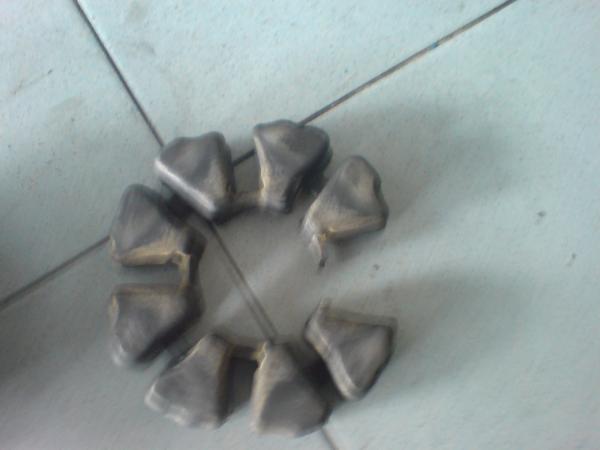

BTW, here's the condition of my old damper coupling, before changing.
Looks like it has taken lot of abuse!
[ATTACH=CONFIG]238584[/ATTACH]
Poor thing, got itself a totally new shape haha..

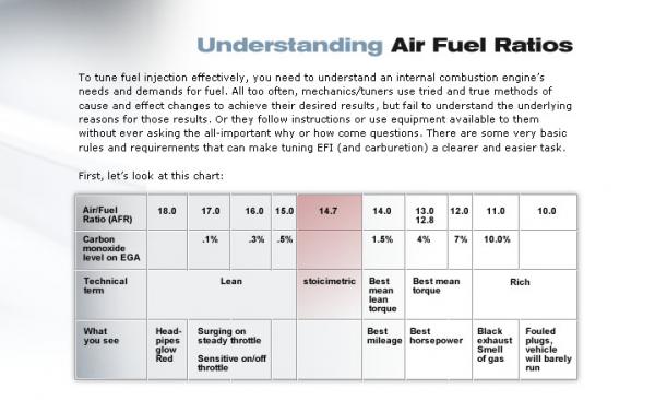

Anyone here can give tips on how to tweak the AFR to the optimal setting and how to know it is good ?
I remember Lindav explained it a few years back, but the damn search on this forum is a pain..so I'd appreciate it if anyone could spend some time doing a little AFR lesson :cheeky:
I read about it before, MJ bro also posted about it, there is that perfect ratio but I dont think it is measured in terms of number of turns. I was hoping someone to tell me in terms of number of turns, what the perfect setting is. But I think it varies depending on various other factors like the condition of the air filter etc so it may be specific to each bike and hence its only left to the pros to be done.

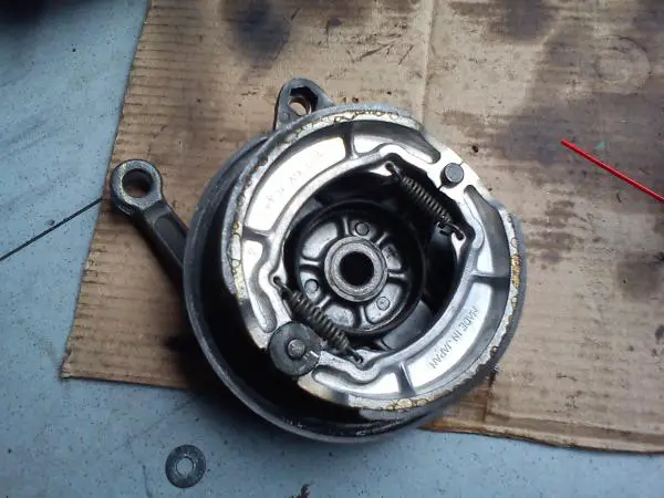

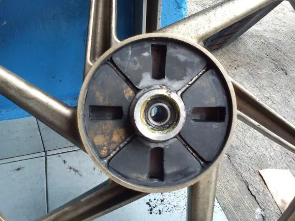

one of the reason why we use aftermarket damper ...
below pic the condition after using around 24000km ...
and this aftermarket brake shoe same brand ASK but this original Japan
worth the the change .... :thumb:

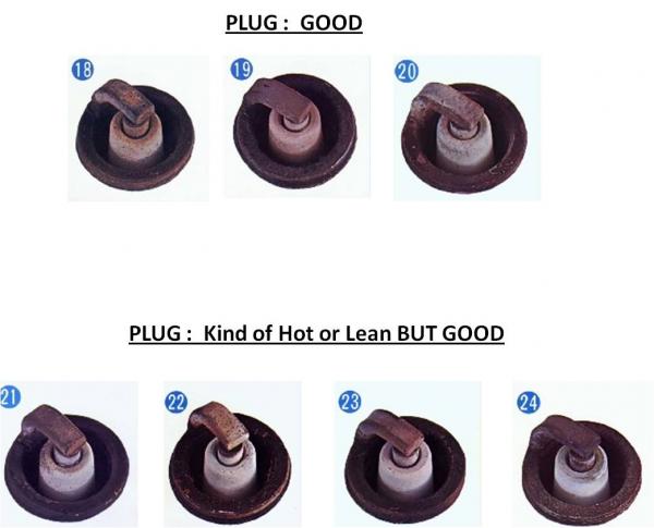

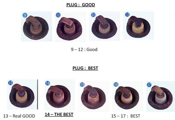

one of the easy way as average or guide only is to understand n know the color of the spark plug ... see my album for the color dat are accepted to be either best, good or acceptable a guide from NGK ... :)
and to play around the numbers of turn is basically just an average since we do not have the proper tools like tuning kit or guage etc .. ...

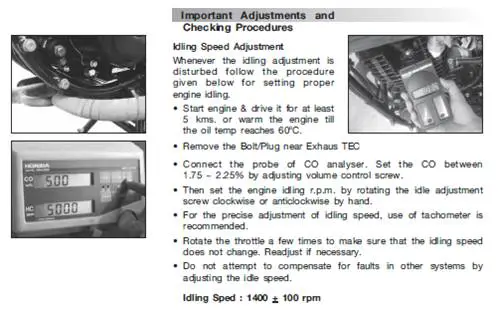

keep the idling speed 1400+- 100 for best idling by adjusting the idle screw to have the idling stable ... see below does not matter if we dont have the tools ..
For the AFR .. what i normally do is always to have my engine warm up for around 5 mins or after riding few rounds or km ... than off it and start with a count of the total numbers of turn ( from close to full open) .. than i will just open 3 full turn as starting point from closed and ride along as usual with alternate speed mid to high rpm yes to whack the bike .. after few km ride i will check the color of my plug according to the guide from NGK .. and make adjustment accordingly .. eg if the color of the plug showed lean reading than i will turn out 1/4 turn each time to make it rich and ride as normal again .. will check again the plug and adjust by turn in or out depends on lean or rich until i get a good reading or acceptible ..
more pic at my album
my idle is kept the same around 1400+- as long it shows stable idling .. i happy with it :)
hmm take note of few things like proper spark plug heat range (ngk 8 0r 9) and good air filter (protec or knn) .. these helps to get better reading ... :)
Oh my method is not a perfect one but still it works like said as long as my spark plug reading as in the range as stated in the guide ...i happy with it ... oops broken english!! .. kekekeke

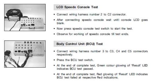

No I think it's the main electrical unit, a little box inside the wiring system.
What you are referring to is the dasboard console, I think that's what Revhappy changed on his latst Pulsar.
okay thanks.. any idea about the price of the dashboard console?
the little box dats the BCU ..
not sure whether at UM they have these gadgets for checking the speedo n bcu ... hmmm

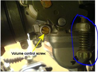

But I have 2 questions:
1. If you change the AFR, how much must you ride to see a change on the spark plug head color ? Basically, how much km until you see if there's an impact to continue tuning the AFR ?
2. Where is the AFR screw ? (sorry, this one is a super mega basic question, but near the idle screw below there ?)

AFR screw is the volume control screw shown in the pic below. Its on the carb, you cannot miss it.
