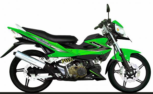

where to check itz specs n details ?looks cool:lovestruck:
thinkin of changing away ur cub :sweat: :confused:

haha, if kawasaki come out this bike, its gotta be a fast cub
Facebook HONDA CB400 REVO
i sense that the fuel tank is not under its seat ... hmmm .. it can only translate in a bigger capacity tank more conventionally placed ...
Yea looks like it could be a tank. Wonder what the specs will be. It looks like Kawa's alternative to the Raider and the Sonic to me.

looks more to me like an artist's rendition.. no offence.
Think it has been released in Indonesia. Kawa Philippines has released it too but under a different name. Maybe can ask our Indon or filipino friends if any. My guess is Malaysia will release it under the Modenas flag as its a kawa subsudiary there. Not sure about singapore though. Parallel import might be a solution.

Found the informations........
Its call the Kawasaki Fury or Athlete 125
http://www.kawasaki-motor.co.id/product/athlete%20main.jpg

TECHNICAL SPECIFICATION
Machine type: 4-step valve SOHC 2
Cilinder number of cc : 124.6cc
Diameter x Step: 56 x 50.6mm
Comparison of Compression: 9.8: 1
Maximum power: 9.9 PS/8000 rpm
Maximum Torque: 8.6 Nm/6000 rpm
Carburettor: Keihin PB18
Starter Starter system: Kick Starter & Electric Starter
Transmission types: Type Rotari
Number of transmission: 4-speed
Pattern transfer Tooth: N-1-2-3-4-N (Rotary)
Gear Type Final Reduction System: Gear
Gear ratio Ke1 3,000 (36/12)
Ke2 1,938 (31/16)
Ke3 1,350 (27/20)
Ke4 1,087 (25/23)
Final Drive System: Chain Drive
Overall drive ratio: 9634 @ TopGear
Ignition system: DC-CDI
Lubricant system: Forced Lubrication
Filter oil system: DFLS (Double Filter Lubrication System)
Lubricant capacity: 1.1 liter
Type of machine oil: API SE, SG, or SF / SAE
Spark plug : NGK C6HSA
Type: Full Frame
Front: Teleskopik - Fork
Back Suspension: Swing Arm Monoshock
Length x width x height: 1,920 x 695 x 970 mm
Distance axis Wheel: 1.240mm
Seat height: 150mm
Julur Depan : 280mm Home back: 280mm
Julur Belakang : 400mm Back back: 400mm
Maximum weight: 104 kg
Front brake: hydraulic, single disc, 2 piston caliper
Back brake: hydraulic, single disc, 2 piston caliper
Tank Capacity: 5.2 liter
Baggage capacity: 4.5 liter
Handle Bar length: 6.95mm
Turn the Corner Bar Handle: 42.5 ⁰
Dimension Front Tire: 70/90-17
Dimensions: Rear Tire 80/90-17
Front 2.50-17 4PR
Rear 2.75-17 4PR
Wheel rim: Cast Aluminum Alloy Wheel
Saat Pembukaan Katup : When Opening Valves:
Inlet:
Open: 20 ⁰ before TMA
Closed: 60 ⁰ after TMB
Duration: 260 ⁰
Exhaust : Exhaust:
Open: 55 ⁰ before TMA
Closed: 25 ⁰ after TMB
Duration: 260 ⁰
Electricity:
Battery: 12V5 AH
Lights
Type: Semi Sealed beam
Head lamp: 12V (18/18W) X2
Brake light / brake: 12V (5/18W)
Alternator:
Type: Outer rotor
Average output: 1.6A/16V @ 6000rpm
When ignition: From 10 ⁰ before the TMA @ 1,200 rpm up to 31.5 ⁰ before the TMA @ 4500 rpm
Color: Black metallic, Lime Green, Blue metallic
Design wise for the bike is abit different......:cheeky:
