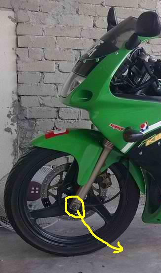

okay i'll try that thanks :) btw another problem happened this morning while i was riding to sch, halfway suddenly the speedometer reading dropped to 0 then all the way like that alr. Speedometer spoil :( can fix? or need to get new one?
cable or speedo or the "round black thing below"

then how you know is which one. :(
http://i1209.photobucket.com/albums/cc393/Siaolian/togetherforever.jpg
MAY THE V4 BE WITH YOU
u put rpm cable to speedo n try
if move
mean speedo meter function,not spoilt.
so left cable n that thing(i call speedo hub)
open cable n check got break
no break,
mean is that hub thing.
check without spend $ thing first
second , check nid spend abit $ thing
last,bo bian...
check those expensive thing n prepare to dig poket lor!
good luck!
