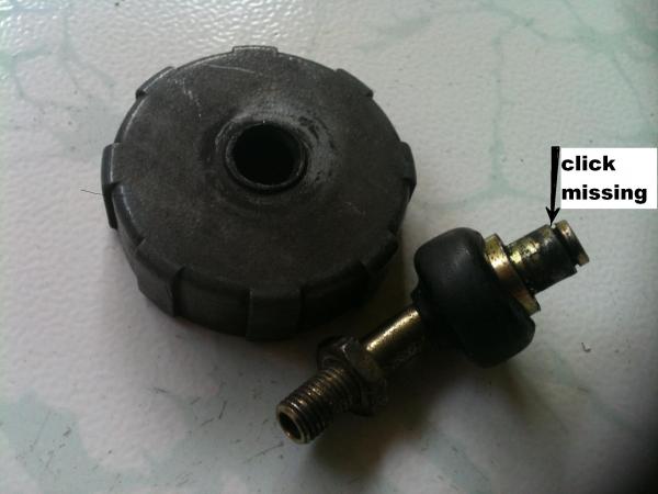

[ATTACH=CONFIG]221986[/ATTACH]
wooo.. what's that? Carb's cap? :)
Yeah tts the carb cap. Haha. And I stay in Singapore. Make friends thru other country krr forums and all loh. I saw u in one of the Kawasaki forums too. But can't remember which.
