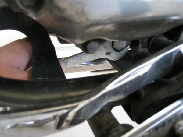

Anyone know the engine oil nut size how many mm is that?
My bike never come with tool :(
