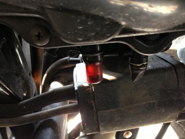

Hi bros, today I realized the pipe under my bike looks filled with petrol, is it possible that is the reason why my bike engine sometimes die after stopping at sloped traffic lights? Should I drain it or leave it alone? [ATTACH=CONFIG]262598[/ATTACH]
Its an engine breather right? supposed to clear that tube once in a while
Just dun pull the petrol tube.
Dragstar 400 classic & Zx6r
I'm not sure what it is.. there's another shorter tube behind the right front chrome cover.. Looks full too with what looks like dirt at the bottom.. should I clear this too?
