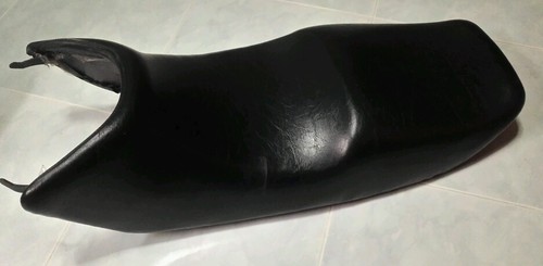

Anyone interested in ST1100 seat, do let me know. Selling my spare for $100, non-nego cause it is really cheap already. I paid Eugene saddledry $120 to improved the cushion and to re-wrap the leather. Now selling a complete seat for a mere $100!!!
