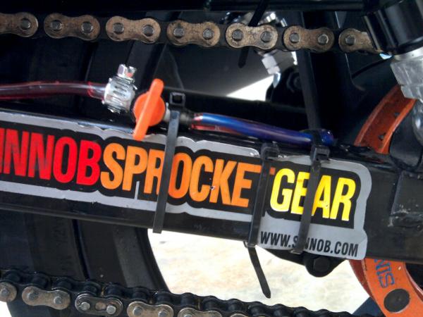

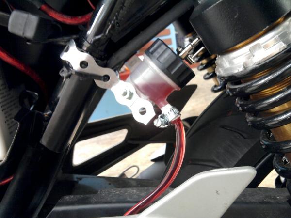

attached is 2 pics of my old set up with the fish tank valve and my oil container...
anyway my fish tank valve lasted me 2 weeks+ before leaking and the tubing also starts to get really soft...
in the end got the metal valve and thicker plastic tubing

my current valve has no leak for the last almost 1 year...
i use 1 valve for both flow control and on/off..
tubing i got 4mm dia which is just nice to restrict the flow to a nice rate...
