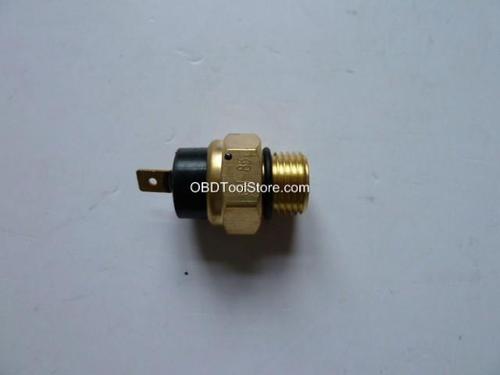

hmm, anyone has a pdf manual for our bike?, so easier for me to see the part number.. is the part number: 37750-PC1-004 - THERMO UNIT ASSY..btw, does the temperature sensor look like this??..
or
[ATTACH=CONFIG]243067[/ATTACH]
or
[ATTACH=CONFIG]243068[/ATTACH]
Second one is correct..the first one is more like ur fan thermal switch.

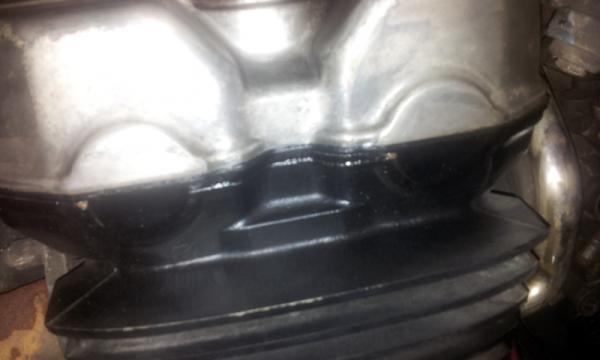

Seems like my top gasket is leaking.. would cost $120 right to fix?.. Also want to ask how much will a valve clearance cost?, got include service of carb in valve clearnce?.. doing my gasket change at planet or bikeworkz as its nearer my house..
