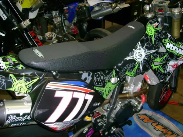

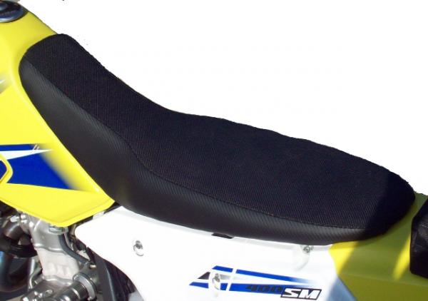

hi there fellow riders,
is it normal for yr gluteus maximus aka butts getting numb after riding the bike?
im experiencing it right after i get off from my bike after my ride.
is it because of the nature of drz engine which vibrates that causes it or the bike seat?
should i change the stock bike seat into an aftermarket one in order to reduce the numbness?
if i do change the bike seat, which seat should i go with? SDG Step seat or DRZ Dual Sport seat as shown in the attached pics.....
thanks for the opinions....
it's very normal..
either tahan, change seat or change bike.. haha..
by far, the best comfort seat for DRZ is from seatconcepts..
it's not cheap, furthermore, they only provide the cushion and cover, you would need to bring it to staple to your stock seat pan if you dun own a staple gun..
But it's sweared by Americans as the best comfort seat around.. (forget corbin and gel seats)
that other photo you posted is the Seatconcepts seat..
I think I'm the only one that uses SDG Step seat in SG..
It's a race seat, period.
Rock hard as wood.. but my butt is used to it now..
Most likely would change back to stock seat if going long distances..
