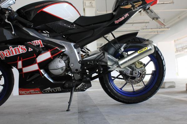

37 Motoring & Ah Seng: Definitely lived up to all expectations. Bike runs like a dream now. He moved the clutch biting point further out, and this alone changes how I interface the bike. Previously the biting point was real close to the bar, which I felt was a little trickier to control but never bothered to change it. Rearsets installed perfectly. Ah Seng initially set it up with the GP shift pattern, but changed it to standard shift pattern when I said I didn't want GP shift for now (not at all his fault because I didn't specify the pattern I wanted when I dropped the bike off). Everything on my checklist done as instructed, so I'm very pleased. I was, however, scared shttless when I reached for the front brake in the downpour and got less than 30% of normal braking power. Could be the recently-bled brakes or grease on the disc or just the PITA rain, but it worked fine after the rain died down a little. A good reminder to always tap the brakes in the rain in advance of needing to use them.
Update: After having spent some time cleaning my bike post-service, I thought I'd post an update to my review above. While I think 37 Motoring did a good job overall, I have to say I wish they were a little more careful with my bike. I can forgive the dusty, greasy state she was in when I picked her up - I guess that is part and parcel of leaving your bike in a garage in Singapore. What I cannot forgive so much are permanent marks left from what looks like a slightly rushed job. For instance, the area around the screws that were removed to remove the pillion pegs (the black plastic bit under the pillion seat) are gouged, mostly likely from a screwdriver slipping off while the screw was being screwed back in. The frame around the bolts of the rearsets has three tiny gouges, I suppose from a tool hitting the frame when the bolts were being undone. There is also a stubborn white residue on the plastic bit bridging the right fairing and frame. These things are certainly not deal brakers, but they do slightly disappoint.
Cry 'Havoc'.....and let slip the dogs of war
Hey guys
Got my bike back on Thursday (thanks xxes123 for the heads-up). Haven't had a chance to have a spirited ride yet. The ride home from 37 Motoring was terrible as it rained cats and dogs all the way. But here are my thoughts from the 20 minute seat time I've had so far. Pictures below too.
Diamond Race rearset: OMG. These things are FTMFW. The pivot on the gear shift has its own bearing, so the motion is just so slick (to quote Jeremy Clarkson, like smearing honey into Keira Knightley!). It's so smooth and effortless that I'm doubting whether I made an upshift at all at times and end up double upshifting! Won't be long to get used to them. The pegs are solid (i.e. they don't fold) and grippy as hell. I've set the pegs at their highest setting and one setting back. Love the new riding position. When the balls of my feet are on the pegs, my inner thighs fully overlap the Stomp grip I've positioned just under the tank, so I now feel even more attached to the bike. Better knee grip = less weight on arms/wrist = not too tight on the bars.
Cost Breakdown:
Wash valve, carb and tune - $45
Flush coolant - $25
Bleed brakes - $16
Install rearsets, remove pillion pegs, attach loose fairing - $50
Rear brake pressure switch (mine was dead) - $48
Rubber roller for chain tensioner (mine was worn as hell) - $25
TOTAL: $209
After the great service at 37 Motoring and my new-found confidence in having a great mechanic to turn to, I'm now thinking of changing the exhaust. I used to like Gianelli only because I wasn't into the GP-look of the Kevlar Arrow, but Arrow's now got the titanium full set which looks close to stock, which I prefer. Biketech sells registered/street-legal ones ($650) and 37 Motoring can install it for around $50. I've read from Sub Zero's and lacrimosae's old posts that I'll need to get re-jetting done and get the woodruff key to advance the ignition timing, and will ensure this is done if I proceed.
I would gratefully receive thoughts from the honourable experts and those of you who have done their exhaust. Main questions in my mind are:
1. Will removal of the restrictive exhaust make the bike any less reliable?
2. Will the exhaust sacrifice low-end power for more top-end?
3. Will the mild-steel expansion chamber rust even if it is painted with high-temp paint? I'm hoping Ah Seng can do the high-temp paint as part of the installation.
Really appreciate the honest and unbiased review you've put up dude. Just 1 or 2 things.
Your braking power will always be less in rain depending on the pads you use. Also I'd recommend you highlight your feedback to Ah Seng. Constructive feedback should always be valued by bike shops. And he'd be more careful with your bike next time. I hope he can help you in removing that white residue you mentioned. Cant imagine what can it be!
I'm not sure if there's any significant power difference between the Arrow and Gianelli but looks wise i'm more for the Arrow. I think it costs about $100 more than the Gianelli so it all depends on what you want. Spraying the high temp spray will wear out after awhile. I just serviced my exhaust and gave him the can to spray myself. The exhaust feels and sounds like new. Sweet!
Also, i notice you're in the market for sliders. I'd personally recommend you go for the whole deal instead of just the front and rear. If you're looking for protection, might as well go the whole 9 yards ya? The R&G look sweet, but it involves cutting away part of your fairings(From what i know). The Motivation sliders do not require you to cut anything. However I've seen a pic of a bike that crashed at track with R&G sliders, and from what i observed, the sliders did their work and the fairing wasnt damaged(whatever was seen in the pic). So definitely it'll be good protection against minor drops and falls. :)
Only thing i didnt like about R&G is the bar end sliders. It looks too chunky and bulky. The motivation bar end sliders look sleeker, smaller and more pleasing to the eye. $60 i think.
Paddock stand bobbins can be found on ebay and http://www.pjme.co.uk in a variety of shapes and colors.
Thanks again for the educational review. Ride safe.
My pleasure matey. It'll be great to meet up sometime in the future to put faces to names! :p
White residue: Thankfully gone! Wife's nail polish remover did the job!
Arrow exhaust: Nice to hear you're loving your Arrow. I love the Arrow look so much I spent sometime last night using MS Paint to see how it'd look on the bike (resulting image attached!). :D
Sliders: You approve of frame sliders? I'm kinda glad to hear that actually. I was in the market for the whole set mainly because I love spending part of my Sunday rides in open car parks trying to get comfortable with leaning the bike (e.g. doing tight circles in either direction, figure of 8) at low speeds (15-20kms), and was worried of dropping it and ruining the fairings. Unfortunately I read reviews that frame sliders could potentially irreversibly damage the frame in a fall, which would be heaps more costly to replace than just fixing the fairings. Come to think of it, that would be more likely in a high speed crash, and not a low speed drop. Hmm. I think I might once again be sold on R&G frame sliders. I will keep you posted if I do get them!
