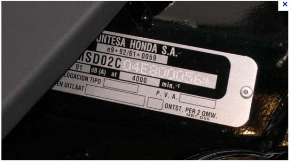

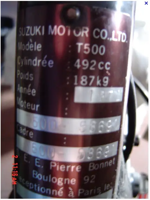

Dear Cb400SF Riders,
Does anyone know if there is and where is the "Model plate" or "Manufacturer plate" or "data plate" on a CB400SF ? In order to homologate the bike in my country I must show it. I know where the Frame number and the Engine number are" but not where is that aluminum sticker (I am not sure the exact name of it in english could be "model plate", or "manufacturer plate" or "data plate", it should be an aluminum sticker ) ?
Would it be possible it is something not obligatory to have on Japanese bike made for Japan (or SIN or AUS) ?
It should show information about the maker (Honda), the Noise level (in Decibel), some Weight info, and possibly the Co2 level (
That would really help me, there is nothing about it the Honda manual.
Thanks
Jerome

For info, I contacted the shop where I bought the bike. Apparently, Japanese bikes over 250CC sold for the Japanese market (+ possibly Singapore and Australia too obviously), does not have any plate like these. (in the contrary to all bikes sold in Europe).
Good rides to all !
