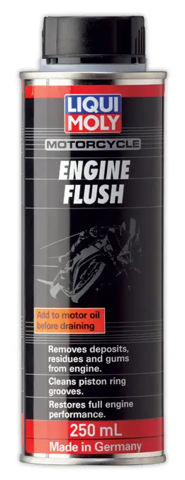

ah pek, btw is engine flush recommended for our motorbikes? eg, brands like ows and liqui moly.
Does it really helps to clean up the deposit which left in the engine for many many years? haha curious in it.. :D
[ATTACH=CONFIG]230590[/ATTACH]
I know don't and can't comment the brand u mentioned as I don't use them. My advise is never use these stuff too often..may be 6 yrs once. They do contain acidic stuff that can damage bearing seals and anything that's rubber. Do it ONLY WHEN NECESSARY like having sludge (metal filings) due to no eo or overly used eo.
