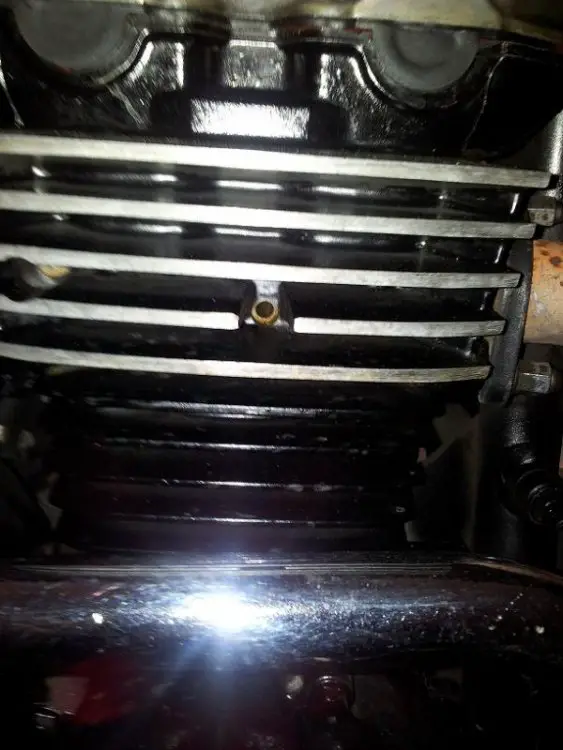

Hi all need yr kind advice...i feel when i ride i can feel slight water splashing on my leg shin area..hot at times..only happen juz aft i move off...aft tat ok...it seems to be coming from the hole in the pic..Any chance its water?....Last week sat i went JB n wash near the shell area...they like jet water in my engine till i cant start..i open choke n rev like mad then engine nv die....should i be worried abt this water splashing or it will go off naturally?

Hot liquid might be your coolant leaking from the hole..

Gasket blown I think. I had water coming out from the other side. Short term soln, Buy rad sealent. Long term soln, time for an overhaul.
Bt mine like comming out frm the hole...i juz replace the top seal...hw know if gasket blown?
Internal gasket. Old VerS/R are known to blow at that area. I had mine overhauled. Once done can last you long time, unless the mech doing it sucks/dishonest.
