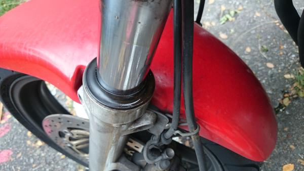

Aftnoon had a ride home den realize my fork, as pic attached, like got oil leak? Anyone can cfm this n wat servicing do I need to do? Change fork oil or top up or fork alrdy damaged?
Fork seal gone bro..replaced a set plus cleaning nd changing cost about $90 in most mototiam. Requets to have 450ml fork oil in it instead of regular practice at 400ml.
Happy New Year 2015!
Thanks ah pek, will visit planet soon
