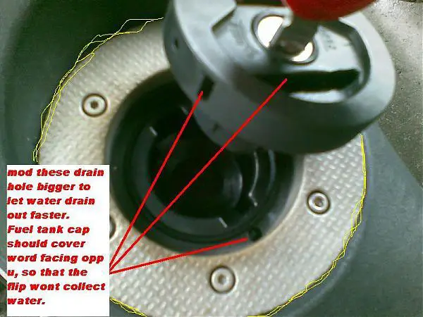

  s15_sylvia said:
Hi mates, just got the bike yest. Mine's 1st hand. Heard some reviews that water can easily seep into the gas tank. Went to the Kallang scooter shops, the solution is a kinda ugly rubber fabric or leather patch covering the fuel pump inlet. Any other tips or advise on countering this? No nonsense responses please. Thanks.
Modify the fuel tank cap!
Mine so far no problem without any cover! :angel:
http://i64.photobucket.com/albums/h187/jackyeng/rsttankcap.jpg
Thanks mates for your comments.
Satgi have anoher query, will water seep in thru the part I highlighted in yellow? (Refer to pic)
There is no way water can get into the fuel tank from the yellow part u highlighted.
