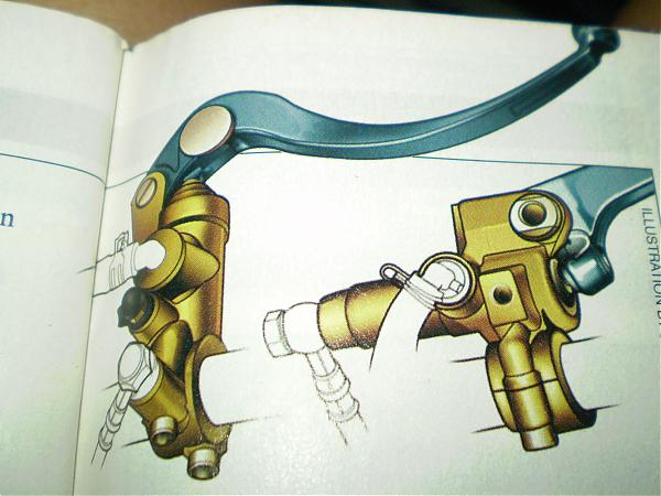

A picture of the circuit of Braking system(1) and radial pump design vs conventional brake pump(2).. I've two parts to share. One is the use of normal master pump against radial master cylindrical pumps, the other being the effect of master cylinder piston size (like brembo offering something like 19x20) on the performance of the braking system.
Q: Any difference between a radial designed master-cylinder brake pump against that of the conventional ones that we have on our bike?
(Note: S4 is using the right pump in the attached picture. Brembo or other aftermarket brake pumps are usually designed similiar to the left pump picture.)
A: (I quote from Paul Dean in his write-up in CycleWorld Nov'07 with some rephrasing and add ons...)
Having seen several different claimed benefits of radial-pump master-cylinder such as increased leverage or the ability to have larger piston diameter, these qualities could have easily been built onto conventional designs.
But really, the only significant advantage of the radial type is their greater resistance to Flexing.
When you squeeze the lever on a conventional master cylinder(the right pump in attached picture), the forced applied with your hand is inward and towards the handlebar; the piston, however, is oriented parallel to the handlebar. Thus, the lever has to turn your squeezing force about 90 degrees to the left.
This causes the entire master-cylinder assembly to flex, since it is mounted to the handlebar only on a relatively narrow perch (a bar or peg on which something is hung). In fact, if you wanted to design a mechanism intended to flex such a mount as easily as possible, it would be hard to outdo a conventional master-cylinder arrangement.
A radial-pump design, however, eliminates practically all of that flex. The force you apply to the lever with your hand still is inward, obviously, but so is the force applied to the master-cylinder piston, which is perpendicular to the handlebar rather than parallel to it.
In fact, the piston is 'trapped' between the lever and the bar, with all of the forces acting in the same direction. Consequently, none or very little of your squeezing force is lost to the flexing of the master-cylinder mount, giving the brakes a more positive, solid feel.
(Unquote)
Next question, if i change to an aftermarket radial designed master-cylinder brake pump, will it definitely help in braking and the overrall increase performance in my bike's braking system?
One will have to contemplate on balancing a bigger piston size(S4 is using 16mm if i'm not wrong) resulting in a lessened pressure throughout the brake system but on the other hand will pump or move more fluid for any given stroke of the brake lever. Till next time... Principles of Hydraulics.
(Unquote)
Most CL2B bikes are 8 or 10mm.
Most CL2A bikes are 12mm.
Most CL2 bikes are 16mm. maybe the italians and euros comes with 18mm/19mm..
i started using OEM 12mm, then 16mm, then 19mm.. did not feel much diff btw 12 and 16.. but 19mm is totally different..
