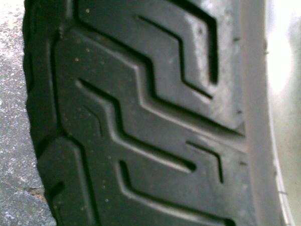

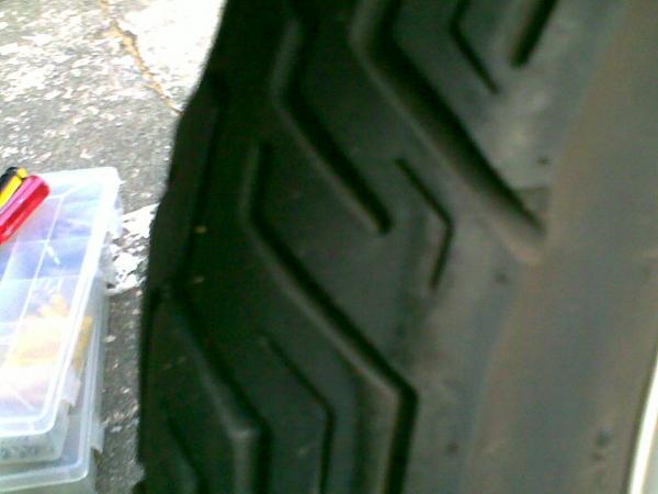

Hey all, I would like to get your advice on two things...
Firstly, the mech I normally go to recently started saying that my rear tyre was 'balding unevenly', and best to get it changed. But I ride even during wet weather it still feels pretty okay, and also around the corners, regardless of wet or dry... The threading on the tyre still appears quite deep to me say about 2-4 mm? So is he trying to chop or the way I'm looking at the balding is wrong?
And secondly, he mentioned that my engine is leaking engine oil, he mentioned something about the engine gasket slight leak, but nothing to worry about, again, is there any remedy for this while its still early?

1. Balding unevenly?
Riding with overinflated tyres can cause the centre tread to wear fast, however you may benefit from less rolling resistance, better FC.
Furthermore unlike car tyres, the bike's tyres are designed to be able to let you roll in corners. If your daily commute involves cruising on highways all year, definitely the centre will be flattened.
Therefore, unless strange wear patterns appear on your tyre, ride it until you need to change it. Post a pic for the boys to comment?

if tyre is wearing fast on 1 side, then its a mechnical problem, solve it 1st b4 changing a new tyre, if not u'll end up with the same old problem, but if centre is wearing faster than side, its normal as wat kalyan has mentioned, what causes a side to wear faster, poor alignment of wheels whilst tightening of chain, bearing worn out, or the less common one is, u've been making more turns then the other side....lol

Kaylan: Thank you for the quick reply, I've attached two pictures that shows my tyre, hopefully its clear enough.. =)

your tire still working condition.. dun need to replace lahz
