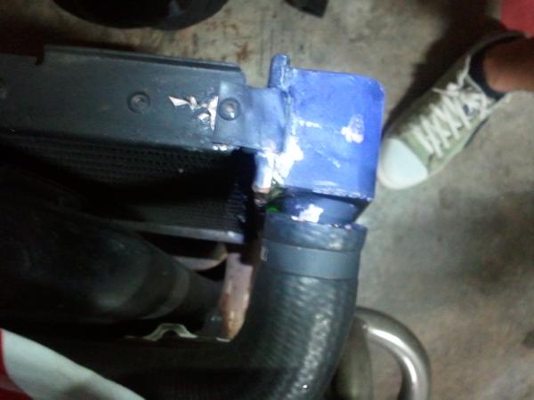

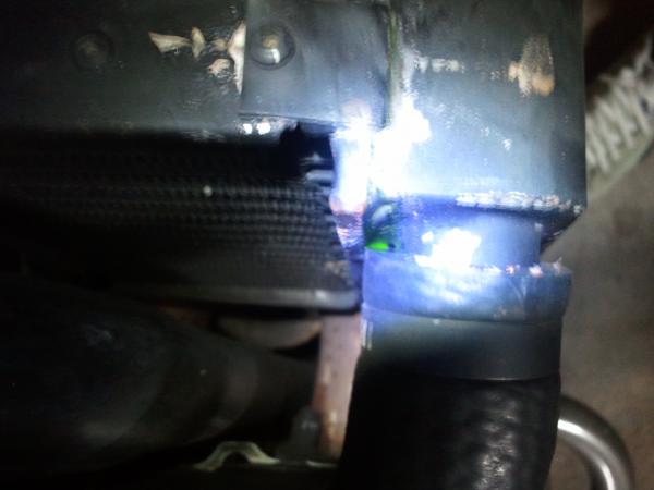

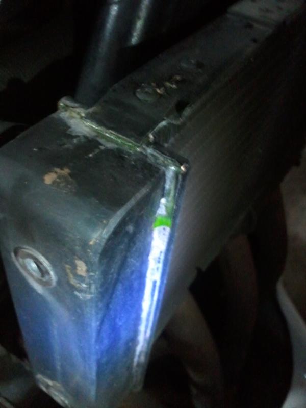

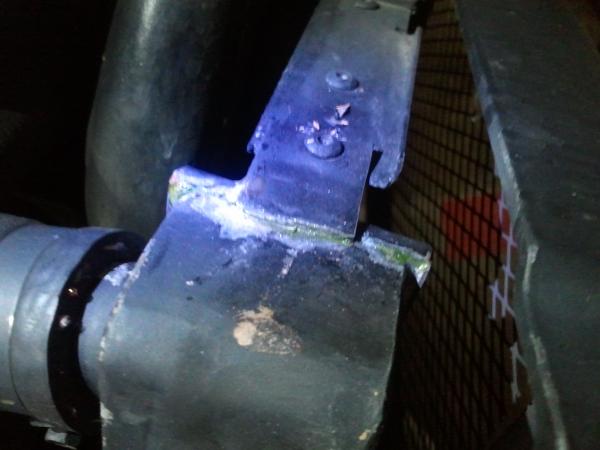

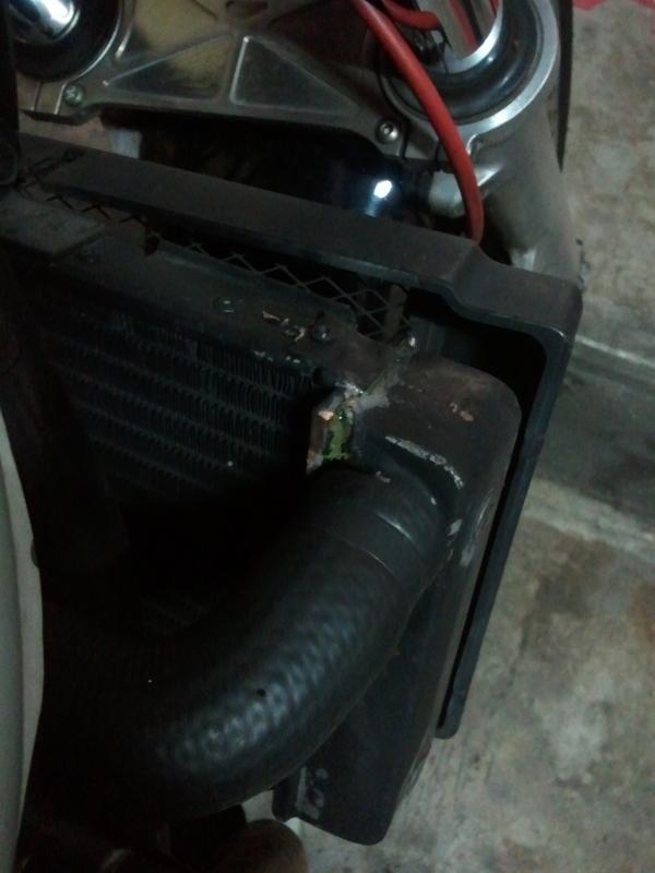

[ATTACH=CONFIG]220276[/ATTACH][ATTACH=CONFIG]220277[/ATTACH][ATTACH=CONFIG]220278[/ATTACH][ATTACH=CONFIG]220279[/ATTACH][ATTACH=CONFIG]220280[/ATTACH]
here some picture of my radiator.. think most probably i will need to change a new radiator. or is there any suggestion what i can do to fix it?
Wah_Lau Ehhh!!!...looks like previously owner ever did welding before. The rusting from inside causes this kind of problem. Better have it change lah brother. Weld very expensive..almost 1/2 price o a brand new one. Oso might cracked else where as its already rusting inside out. Need help pm me.
