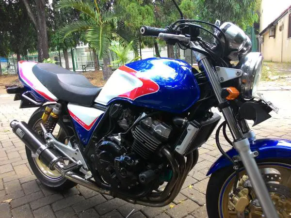

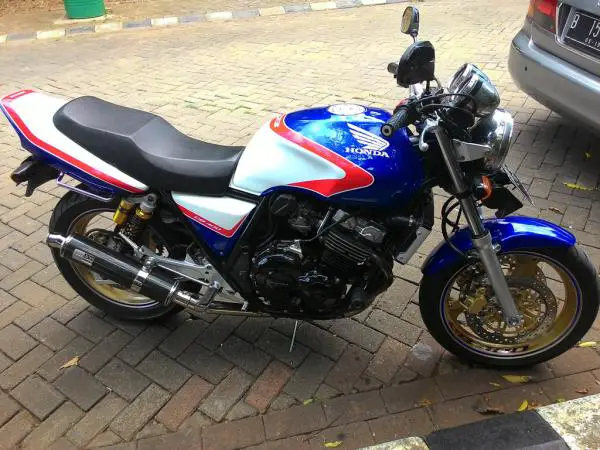

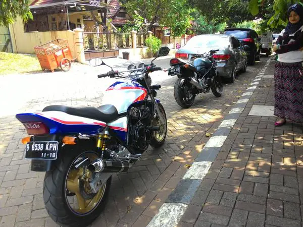

  dymasarya said:
hi guys,
i've just bought 1997 super four. Just want to ask question, can i use vtec spec 1 tail light? it seems the same tail light with 1997 s4.
Thanks
[ATTACH=CONFIG]326086[/ATTACH][ATTACH=CONFIG]326087[/ATTACH][ATTACH=CONFIG]326088[/ATTACH]
Better not..Vicom inspection if the inspector see it..u fail.
