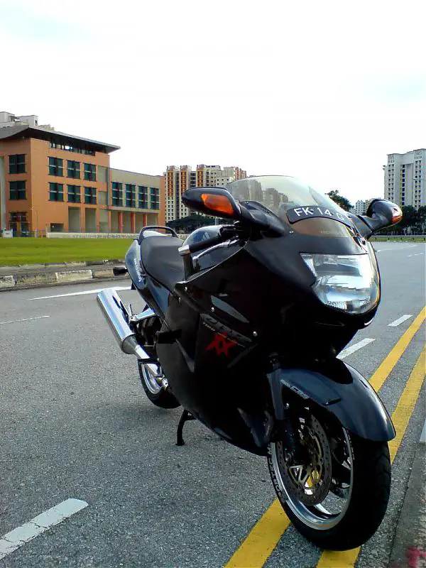

Just refuel today,2nd refueling for me. 333.4km / 18.5L = 18.2km. Good FC I suppose,could be that I jz service and cleaning of the KNN air filter......
Refer to my BB pic, 'like' the reg.no? Hee.....
