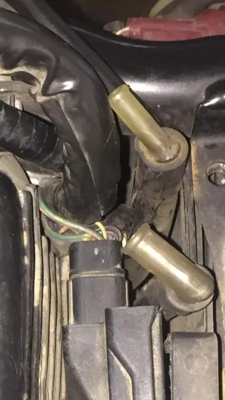

Hi,
Any of you Revorians encounter sticky throttle before? The situation is if I leave the bike for a few hours and especially so during overnight, the next morning when opening the throttle, it will be sticky and need to use a bit of force to first rotate the throttle handle. Thereafter, it'll be okay until the throttle is left untouched again for a few hours or more.
I found that it's caused by the sticky oil residue on the butterfly valves in the throttle body. I had used the THREEBOND throttle body cleaner to spray onto the throttle body just before the butterfly valves. The sticky oil residue was then dissolved, but the symptom will return again after about 10k km. I have also noticed that this sticky oil residue is coming from the breather tube leading into the airbox. Any way to modify this breather tube?
