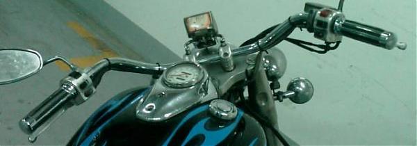

hello, i came across this bike with this low profile handle bar. was wondering what handle bar is it and where can i get it installed on the steed. anyone knows?
just in case the owner of the bike in picture is here, : "sorry i used your pic, but i cant think of any better way to describe how the handle bar then a picture of it."
I believe Steed usues 7/8 inch bar so generally all jap handlebars can use.
the one in the pic looks like 7/8 inch so should also be fine.
installation is easy as long as the clutch cable and throttle cable and brake hoses are long enough.
where to buy, i dont know becos i lost touch with cruiser market in Singapore long ago.

that is a dragstar classic. bars are1 inch diameter. 7/8 are bars for phantoms and rzx.. . plus this guy reused his 1 inch controls .. can tell from there. so should be able to use with a steed. 400cc cruisers usually come with 1 inch bars stock. this may be abit too wide for your steed. but if its the style u like, u should have no problem fixing it up.. however if u riding the springer version then cannot liao..
I tot Yamaha handlebars usually more bull horn like?
the handlebar looks like the original to me.. but i'm not a 100% sure...seldom see classic owners change their bars as the original bar is about this shape and is quite wide.....unless they wanna get dragbars la.. but i was jus pointing out.. if it can fit the dragstar, it can fit the anything with 1 inch clamps.

i guess the last thing would be where i can get that handle bar or where can i do installation. i guess i do not need an original one, a chiong one would also do the job. original one more ex rite?
the job is really easy... if u know how to tighten and loosen a bolt.. u can do this yourself. its that simple.. jus make sure u got long enough cables.
things to note:
almost all throttle/switch housing has this little knob protruding from inside the clamp that needs a hole drilled in the handlebar to firmly secure the housing to the bar. it may seem unclear now.. but u will be able to see it once u take apart your switch housing. some bars may not come with this hole predrilled.. u will have to drill this yurself.
