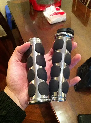

Hi, does anyone know how to change the bike accelerator grips?
i tried looking in the DIY corner but dun have. any instructions welcomed.
[ATTACH=CONFIG]232758[/ATTACH]
Just pull the damn thing out or cut it.
its glued on the inside.
Dragstar 400 classic & Zx6r
just twist and pull. keep twisting until its out. then to put in, use BRUTE strength.
Got bike must ride!
SYM Maxsym 400i - 09/11/12 to current
Phantom TA200 - 07/08/09 to 09/11/12
u hv to unscrew the end caps 1st, 1 hand holding the cap tight whilst the other using abit force to unscrew.
thereafter, u'll need an air gun, this the best tool to help extract the grips.
to install, reverse the abv mentioned.
do @ shop, bt ask nicely 1st..
bro where u bought this grip and how much is it? if the hole is too big u might have to use another slimmer grip on the inside, thats what happened to me last time and it was a pain in the ass to install
U hv a gd selection on ebay. Make sure get those for 7/8 inch handlebar. If u dun wanna go bikeshop, can get the compressed air in a can. Those to dust computer one. Nt as fast as airgun but still okay. Then to fix on, use contact cleaner slide onto d bar, then after dat it will evaporate.
:thumb:

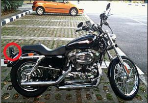

ah koon got sell the number plate bracket.

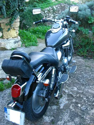

hi pk's, i got an almost stock 03 ta200. does anyone over there make elongated fenders and ships them to europe? thanks
since these pics, i added a straight handlebar, removed sissy bar, front pouchbag and replaced the passengers floorboards(which began to rust heavily after skidding) with footpegs.
