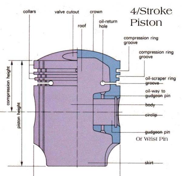

notice the oil return hole. if it choke, after adding 2t , pls don't stop hor.... the 2 t will be the only lubrication as the 4 t oil cannot flow liao......
but 2 t is good for controlling the rust in the fuel tank....so how?
our bike our decision.....cheers

ChaoPuzzy1968 got a good point on the piston. But the rust in the tank wouldn't help by adding 2T, it is mostly kept rust free by the petrol. So if bike needs to keep for long time, remember to fill full tank. (btw your name is ..can change or not?)
Icewater got a clear picture on how 2 Stroke engine works, but I want to point out the below:
1) 2 stroke engine got better exhaust result then 4 stroke is that they do not have valves, 4 stroke comes with many valves, from 2 to 4 to now 5, may be 6 in the future, the problem with valves are tight fitting is required, a bit of carbon residue will give problems, 2 stroke just like fart..so **** in the exhaust hole also no big deal. So your statement on completely purged out should be think again.
2) Even 4 stroke engine is making 6000rpm, the exhaust only happen 6000/4= 1500times, not as frequent as you might think, and for burnt oil stay in the burst chamber for so long bad+bad...
3) No matter how small amount of 2T add into 4 stroke engine...only do more harm then good.
this is a good link to understand 2 stroke works, remember no oil sump for 2 stroke, due to the opening for exhaust and intake, note that 2 stroke exhaust so well that unburnt oil can be exhausted out.
http://science.howstuffworks.com/transport/engines-equipment/two-stroke.htm
