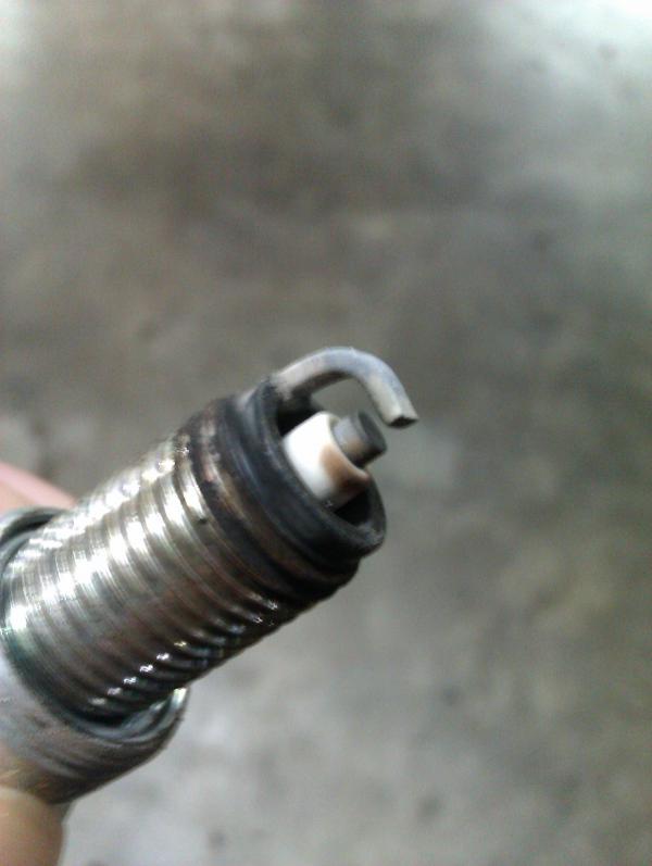

anyway, heres a pic of my spark plug for those who are interested, never touch the fuel mix screw since ah chong tuned it after service.
nothing absolutely wrong with it, brown tan on electrode shows it is running balanced. @stsoh would have pointed out earlier.IMAG0333.jpg

take note of the blackie ground threads....
suspect as much ...... that is carbon after 1 mth. will carry out the regime for another 5 mths then do a top servicing to see the valve , cylinder and piston
Of course the screw threads will be black. That's called "normal". As stated in post #424, look at the pics. All threads will be black.
Some carbon will inevitably be deposited in the threads. It's also why if one were to accidentally use a plug with too long a reach, it might be difficult/impossible to remove the plug cuz of carbon deposits on the threads.
Only need to be interested in the insulator colour and whether the electrode shows sign of metallic deposits from pre-ignition.

i see..carbon deposit on threads is normal?
will these carbon be deposited elsewhere?
hey your 2t is suppose to be ashless...burnt into nothing remember??
answers to the above will b enlighting..
after 1 month of riding..the threads are coated with carbon deposits...ater 5 months will it have 5 times more deposits?..
Yes it is normal to have carbon deposits on the screw threads. Go and pull your non-2T spark plugs and tell me there are no carbon deposits.
Anyone worth his/her salt who has worked on their own machines will know that plugs inevitably will have carbon deposits at the threads.
The threads see some penetration of the fuel mix but might not be exposed correctly to the flame front or there could be quenching from the metal around it. Either way, there will be some fuel which will seep into the screw threads (as all gasses will do) but will reach only to a few threads deep due to the spiral nature or the longer route the fuel has to take along the screw threads. Or other eddies etc as a result of fluid dynamics.
As such, there might not be complete combustion of the fuel within the area of the screw threads, leaving behind carbon deposits.
You can go to any bike shop and take a look at their old used plugs. Those from 4stroke engines if you want. All will have carbon on the screw threads.
Nothing to do with 2T.
P.S.: As mentioned again, am not using 2T. There will always be deposits left behind from something or another. The question here is whether 2T used at such low concentrations can be effectively cleared out by other detergents in modern fuels during the combustion process and does it leave detrimentally more behind than the normal deposits left by otherwise regular non-2T mixes.
