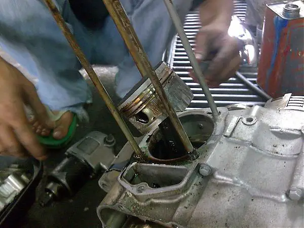

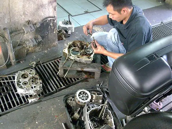

finally went down to planet to get my bike checked. ah chong concluded my exhaust catalyic convertor is broken. he said tt one can be cut away for $60. then engine wise,have to do top overhaul and he quoted me $400 or it.
overall consultation at planet was good. though i know its gonna burn a hole in my pocket.
so i went to my regular mech at heng motor. he told me its better for a full overhaul. he checked everything including my exhaust and my ta200 was emitting white smoke. i watch the opening up of the engine and condition was bad inside esp my piston. and when he drain the eo away, there's only abit left.
