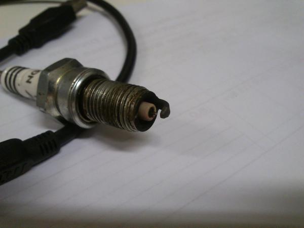

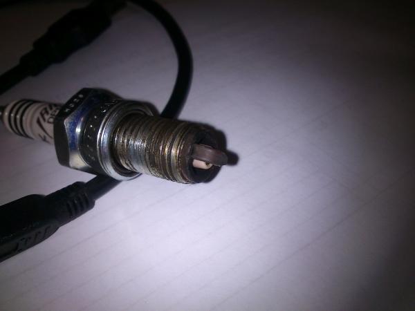

Good info anyway. I removed my single plug after 1500Km running with ~1.5ml(2t)/ltr of Ron92 SPC petrol.
[ATTACH=CONFIG]226331[/ATTACH][ATTACH=CONFIG]226332[/ATTACH]
nice pic , just to check , is the black stain wet?

This is not conclusive, I did not see the plug before I started the addition of 2T. The dark strain
- on the thread - dry, patchy and black
- Ground stem - brownish
- electrode - iridium tip is shiny, the body is darker same is the rim. Looks like carbon
Plug is dry
I am running without 2T now on SPC Ron95 with a new plug. my weekly milage is 250km. See the plug in 6weeks time.

yup the rim , the black stain was it wet?

looks like normal usuage on the spark plugs. brownish on the electrode, black dry carbon on the outer threads. same as mine.
February 2011 - March 2012 = Phantom TA 200
March 2012 - August 2013 = Suzuki Impulse 400
Present = BMW (Bus, MRT, Walk)
Exactly, as CSV mentioned, looked perfectly normal.
Light tan(brown) on the insulator.
Courtesy of Dan's MC, copyright to him and NGK spark plugs.
http://www.dansmc.com/spark_plugs/spark_plugs_catalog.html
Note, all the rims are sooty.....even on a normally running, not lean/rich engine, it still will have deposits. Plug recess hard to keep clean.
Note the electrode insulator colour, oil fouled, the insulator is black and wet. In Limsteel's pic, it corresponds with normal/regular pictures.
